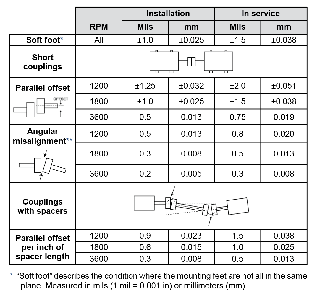

Alignment + Vibration
Align the motor to the driven machine, especially if the two are direct-coupled. Misalignment can cause high vibration levels that damage bearing and loosen mountings. Laser instruments are available for aligning both coupled and belted drives. If alignment tolerances aren’t available from the machinery manufacturer, use those found here:
Alignment procedures include testing for and correcting a “soft foot” – a common problem where the mounting feet aren’t coplanar and therefore do not all sit flat on the motor base. Unless this problem is identified and corrected with shims, tightening the mounting bolts could twist the motor frame. Soft-foot tolerances are suggested in the table above.

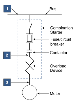

Power Factor
Power factor is the ratio of kW (kilowatts) to kVA (kilovolt-amperes) in an AC circuit, which for a given load (kW) will be between 0 and 1.
Raising a low power factor will decrease the current flow through the motor’s power cables and other equipment and therefore reduce heating and thermal aging. It may also reduce energy costs (where applicable) by decreasing or eliminating electrical utility surcharges for low power factor.
This figure shows where power factor correction capacitors could be installed in a motor circuit. Location 2 is usually best for most motors, and Location 3 is usually better than Location 1.
  • Locations 2 or 3 are offline when the motor is offline; Location 1 is always energized. This could lead to overvoltages and transient torques if other motors or other inductive equipment are on the bus.
  • Location 3 requires downsizing the protective devices because of the reduced current flow.
  • Location 3 could introduce high amplitude switching transients or current surges into motors that jog or switch frequently–e.g., elevator, multispeed, open transition autotransformer or wye-delta start motors, and some part-winding start motors (except so-called extended- or double-delta models). Location 1 is better for such applications.
